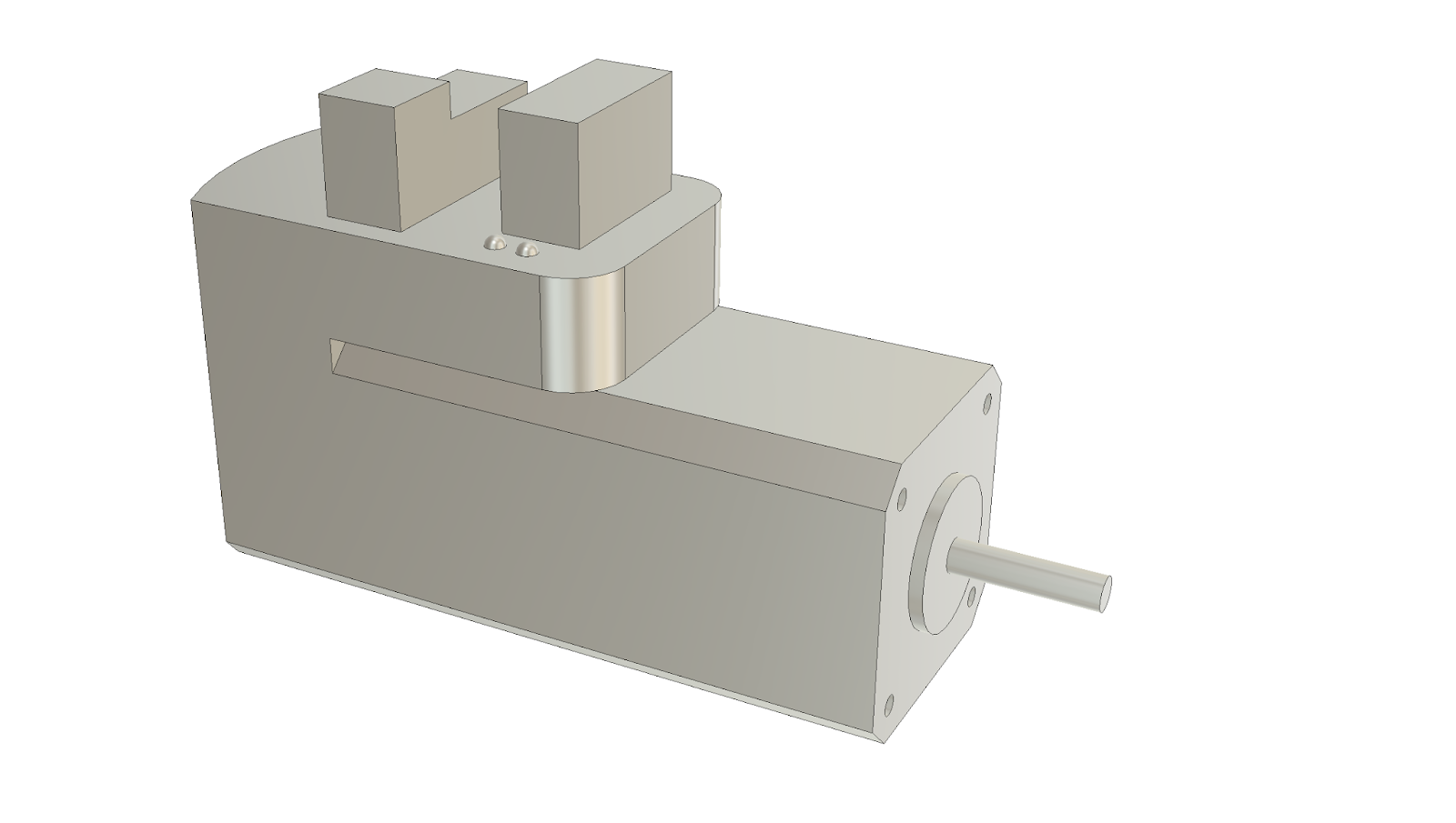

It started with NEMA-17 steppers, then went to NEMA-23 steppers, and as of two days ago, NEMA-17 servomotors. The new motors are 75W integrated motors with 1000 line encoders. iHSV42-40-07-24 parts ordered from China for about $90 each. I operate the servos at 1000 steps/rev, which translates to 31.25 steps/mm. Each motor has its own fanless 24V power supply, one rated for 150W and the other, which also powers the controller and LED lighting is rated for 200W.

Yes- the same mount. NEMA-17 is a standard, even in China. I used 75W motors- there is also a 50W version that’s a little shorter and probably more than strong enough. The price difference is about $5, so I went with the bigger motors.
I put together as much info on the motors as I could find here: https://drmrehorst.blogspot.com/2020/04/ihsv-servomotor-information.html
and a Fusion360 model is here: https://a360.co/2XSC0EP
I have not done any tweaking of any of the motor driver parameters- it’s just running with factory settings, so you may not need to get a USB to serial converter.
